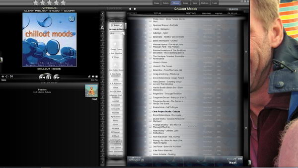

d003232 has attached this image:
posted on 11-26-2010 at 04:29 AM
instead of 500 do 500 x 15
d003232
Posts: 57
Registered: 7-25-2004
posted on 11-26-2010 at 02:53 PM
Thx. I did my first steps and could manage some of the points.
Still I could not manage to set the width of the left panel. If I maximize the screen the left panel is always set to the half of the whole screen
width. If I reduce the width of the left panel with drag and drop the whole windows width of EJ will be reduced according to the width of the left
panel (so you see the desktop behind the EJ window).

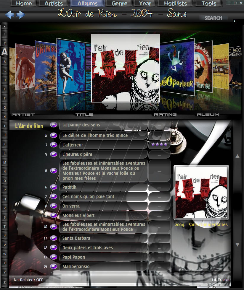

posted on 11-27-2010 at 04:11 AM
i will be adding an option to hide the genre and year columns and instead make track titles and album images larger.
before i add the checkbox for it please try this exe and let me know what you think. are the track title areas wide enough? You can clone the original
vinyl skin again to a new name and then you only have to change the font size in the songlist's .title .titlehi and .titleedithi
Shutdown EJukebox and replace over your existing C:\EJukebox\ejukebox.exe

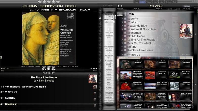

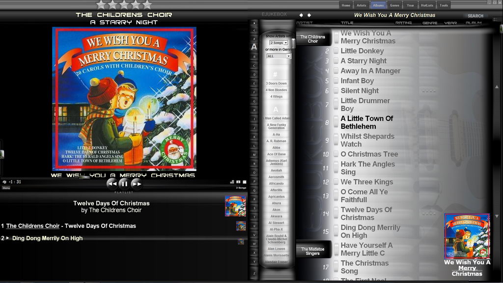

posted on 11-28-2010 at 09:08 AM
started working on an option to stretch the right side wider...an extra 300 pixels on the right like this should be enough for 1080p.
This screen is at 1600x900 so your left side would be bigger. the wider right side is still in the experimental stage. more time and allot of coding
will be needed to get this fully working as an option so please be patient with me.
The 2nd screen shows the current maximum right side width for comparison.
posted on 11-29-2010 at 11:20 AM
made allot of progress...you can now try the wider right side
It stretches the right side 310 pixels wider than normal on screen resolutions of 1600 width or higher.
There is also the new option towards the bottom on the display options panel...Hide Genre/Year Columns
Try it out and let me know what you think...
