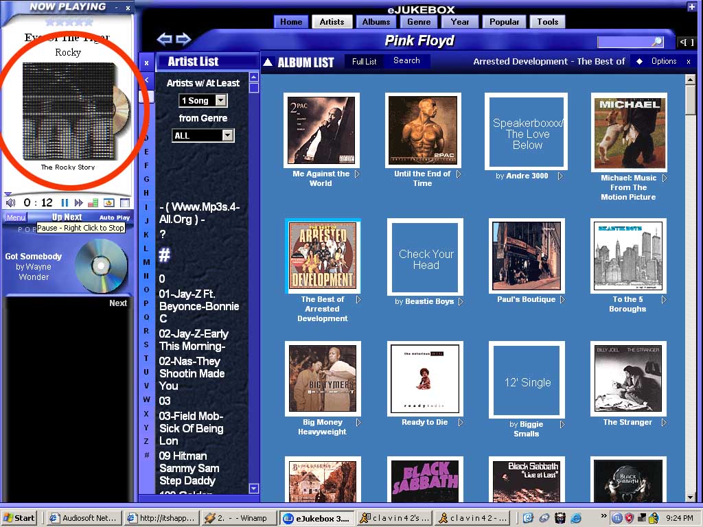

Having issues with larger Icons
First I would like to say this is a great product. I just wish there was more information available about how it works and known issues.
I am having a problem with the CD icons. They will work when they are small (3 and 4 per row) but not when set at the largest. The icon in the left
pane also does not work along with the larger icons when they are used in playlists.
I can not figure out what is going wrong. I have included a screen shot of the problem. Sometimes the picture will work when larger, but not most
times. Most times it looks like it does in the included pic...

clavin42 has attached this image:

posted on 10-7-2004 at 08:13 PM
Unfortunately, the album lookup site eJukebox has always used stopped making large cover images available about a week ago....downgrading to v3.88
will do nothing except show no large image at all (when the large image was not already downloaded to eJukebox)...as it will try to download an image
that no longer exists online. Also, the lookup itself no longer works in versions before v3.95.
v3.96 attempts to fix this problem by getting the large images from amazon.com (instead of the old server which no longer has large images) and if the
image is not available on amazon it will resize the medium image to large size (though it looks like this resize is not working correctly for some
users)....we are looking into this.
The best way to fix these albums is to use eJukebox's editor and INFO button to find the cover online and drag it to the eJukebox editor: to
permanently encode the image itself inside the mp3's ID3 tag. Then click the SetImage4All button to encode the image in all the songs from the album.
Doing that or using Tag&Rename is the best way to permanently setup your album covers.
eJukebox users that primarily use eJukebox's automatic cover lookup (instead of ID3 tag encoded or cover.jpg cover images) should:
Backup their ejuke.asn file as it has all your previously downloaded cover images inside...then use that backup file in any new eJukebox installations
so when you build your database it will always be able to get the previously downloaded images from the ejuke.asn file. Rebuilding your music database
does not delete these images from the ejuke.asn file.
v4.0 will switch the auto-lookup to use amazon.com's XML service so that it will only find album covers that have large images, as well as perform
the lookup much faster and avoid problems like this in the future.
